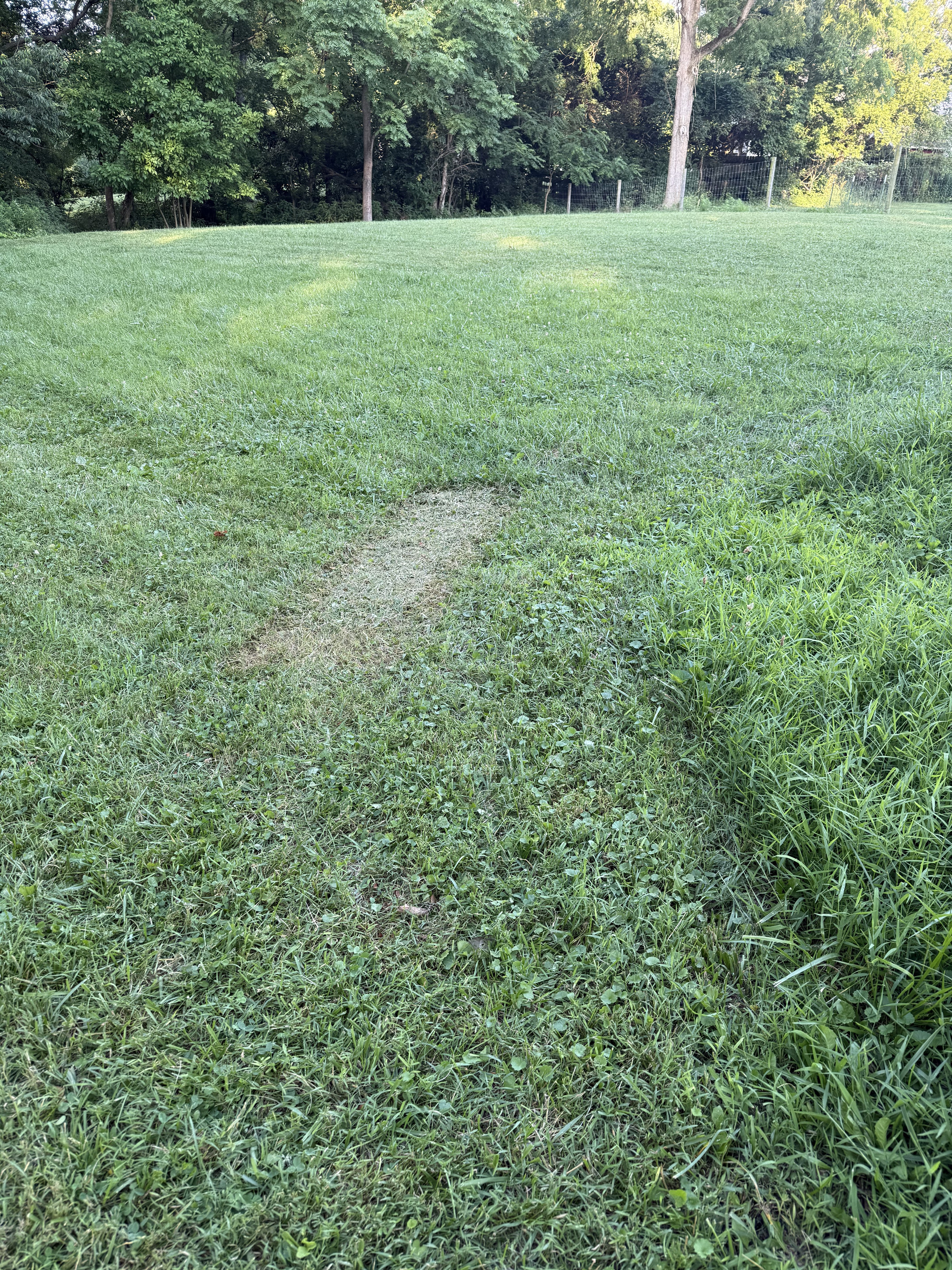

Went on another scalping adventure today.
Seems worse than what I had.

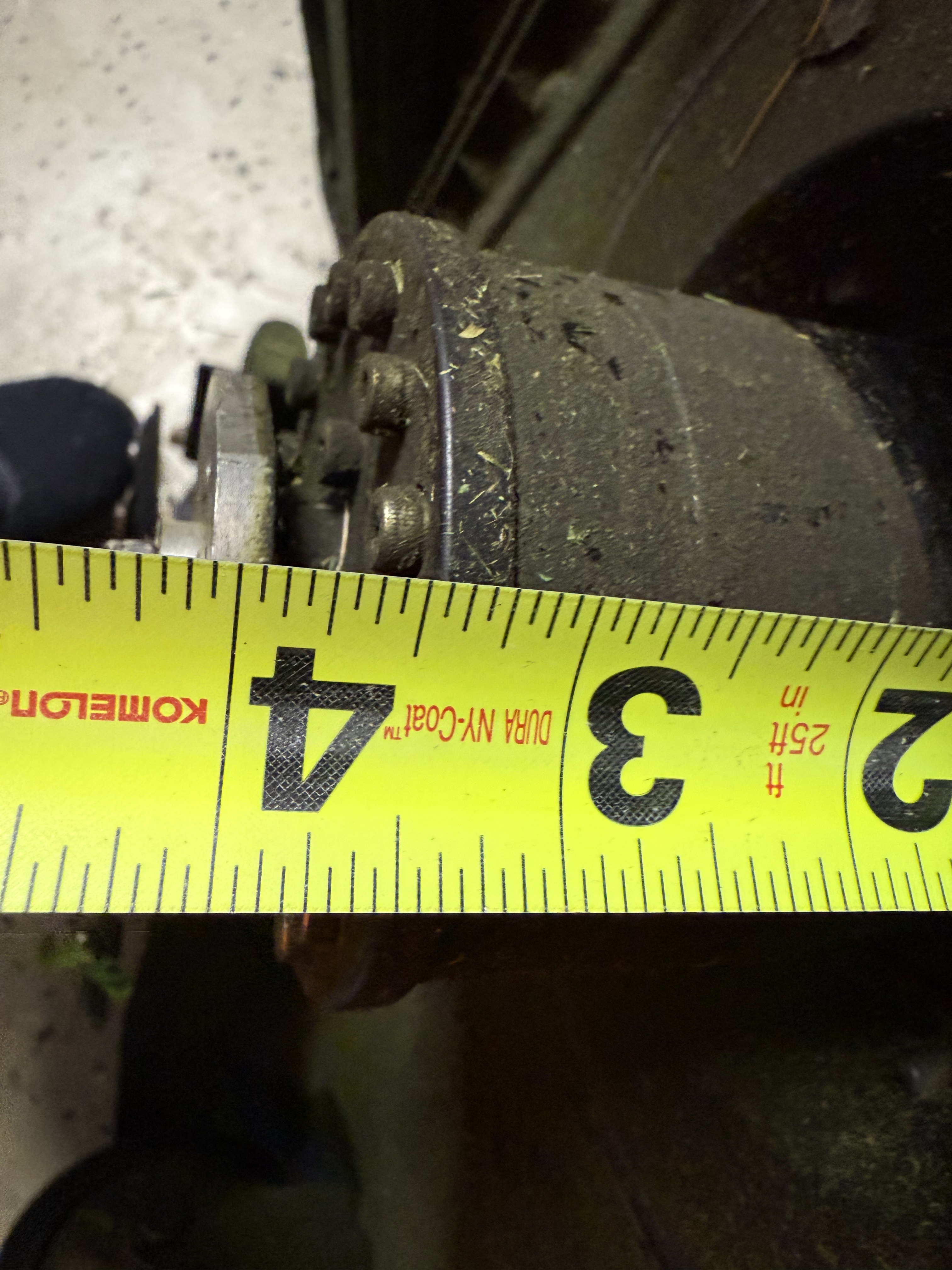

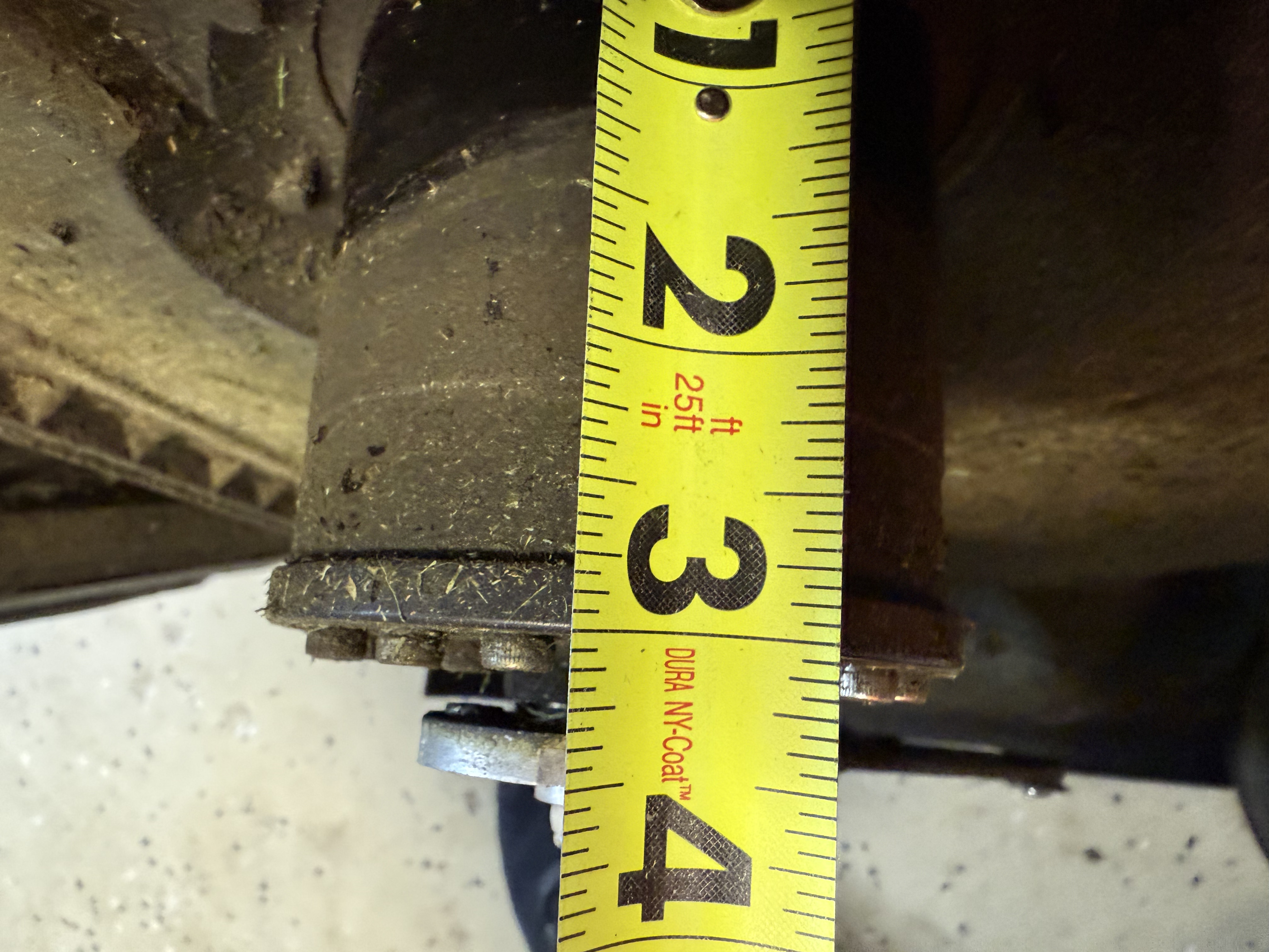

While it was working properly I took a measurement on how for down the Cutting motors are at 1.2 inches. Looks to be almost exactly 3 inches from the “wiper” to the end of the cutting motor.
When it’s hosed, it’s about 3.5 inches.
Pretty sure it’s driving to end stop and then doesn’t have the torque to bring them back up.
