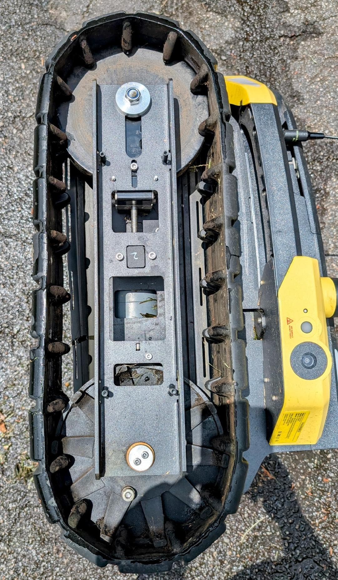

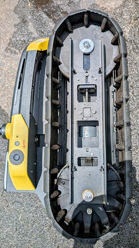

To update. I got back, checked the left, and right side tracks. No blockages. removed tracks, no blockages. Right side track would free wheel normally, just like when I remove to clean and grease. Left side didn’t. I tried moving front to back, back to front. After maybe 5-6 tries it freed up. So wondering, if something in the gearbox on the left side maybe sheared off. Locked it up caused and over amp, and tripped it out. Or did I free up something loose in that gearbox now, that may come back to bite me later. Charging him up now, will give him some test runs close to the charger, and power supply. You should see how 1 man, gets Yarbo out in the middle of a yard, with no help. Wasn’t easy, and it will make you think about what you have around the farm that might help. It wasn’t fun at all!:wink:

No just the normal whine, just like the day I got it. No clicking, or popping. I just got the error last night. Went to check it out. Right side was trying to move, Left side said not today. After pulling the covers, and tracks didn’t see anything out of the normal. Put everything back together. That way I could get a good hold to spin it. I do this around a couple times when greasing. Left was locked down. Like I said , I just kept working it back an forth to see if I heard anything, or felt anything odd. It just freed up. I’m just hoping a gear hasn’t popped off in side. Freed up for a few until it gets caught up again, puts a bind on it causing it to over amp. And then Error again. It will be behind the barn, if it does on the back side of my property. Don’t forget we’re going to be having rain over the next few days.:wink:

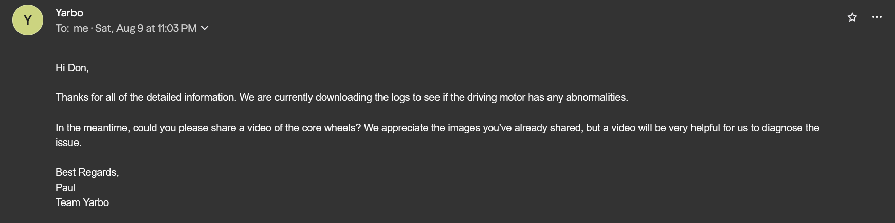

@yarbo-forum @marco Just got this back from them. After telling them it does good to get back to the charging pad. Only one person here. Can’t drag him back from the yard again. So remove the tracks again to video what? The core wheels not working. The sound of grinding gears. I’m sure there is an AMP spike between right side and left side with the sounds I heard. It’s almost midnight. They just came into work maybe. Go outside an video what??? Yarbo on his side, making sure my pics are good??? This isn’t the first issue I had to fix for them. Support Ticket #109358Support Ticket #109358
They likely want to hear the noise or see it not working when you mash the controller forward or backwards. Helps them rule out wheel controller issues vs a mechanical issue. Part of the troubleshooting process. Definitely frustrating, but understandable.
Well I guess in the morning I’ll place it on some kind of jack stand or something. NOT hauling this thing back out of the yard. I know they can see the spike in amp draw. I did this at the hospital with so many things. Either remove it from the floor. Or Remove it from the floor. You didn’t play that game with peoples lives. FLUKE. My best tool…:wink:

Sorry for the late reply, and thank you for sharing the video. We will escalate your case to our field service engineer for further investigation, and I’ll also follow up to ensure it’s resolved smoothly. We appreciate your cooperation and patience.
