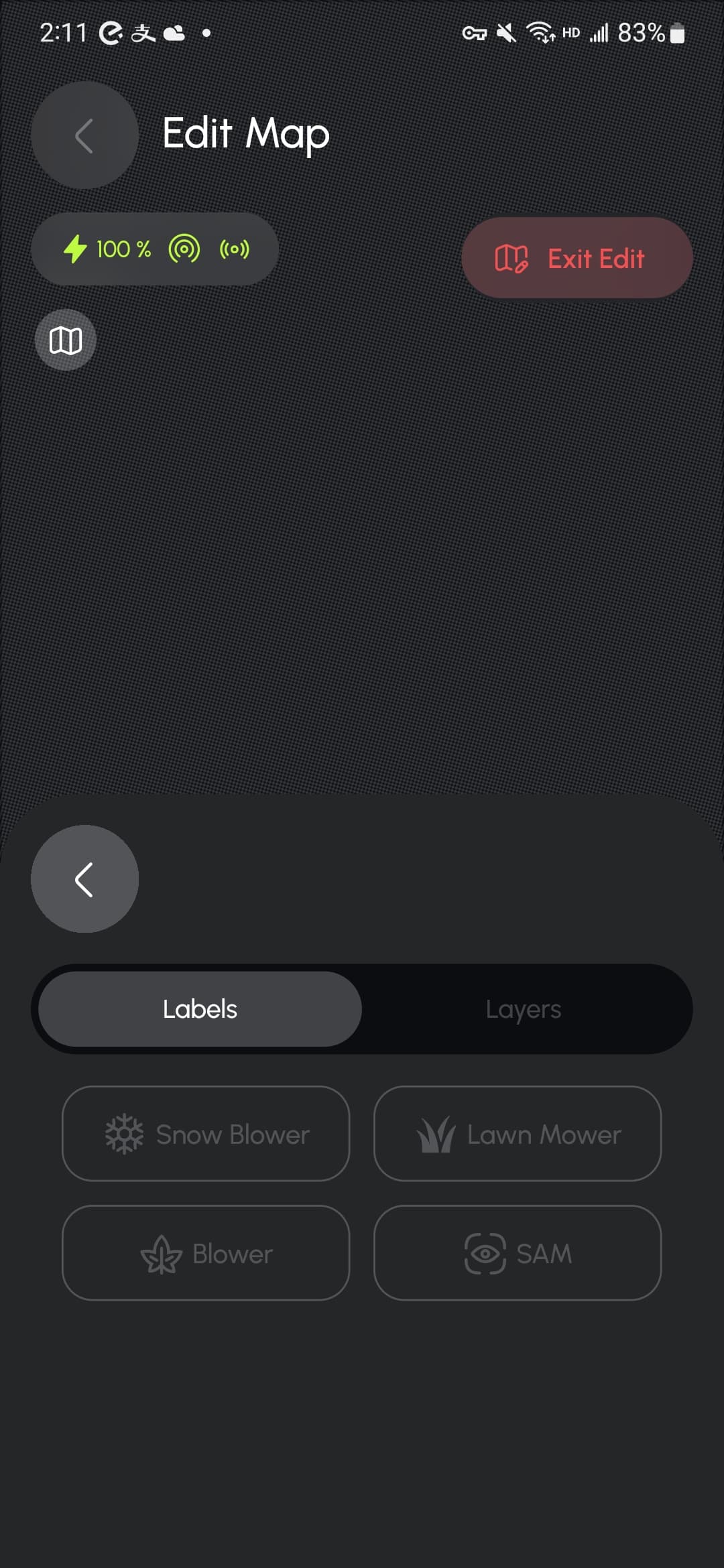

  1. Function Labels for Areas
You can now assign function labels (such as Lawn Mower, Snow Blower, Blower, and SAM) when creating or editing areas. Multiple labels can be applied to a single area.
Additionally, you can choose to view the map filtered by specific function labels, or see an overview of all mapped areas at once.

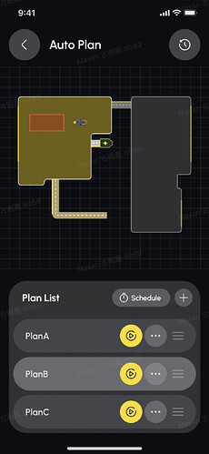

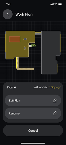

  1. Plan List Improvements:
In the Work Plan → Plan List section, you can now reorder your plans by simply long-pressing and dragging them to your preferred order. Once adjusted, the new order will be saved automatically. When you open any plan, you’ll also see the last work date for better tracking and planning.

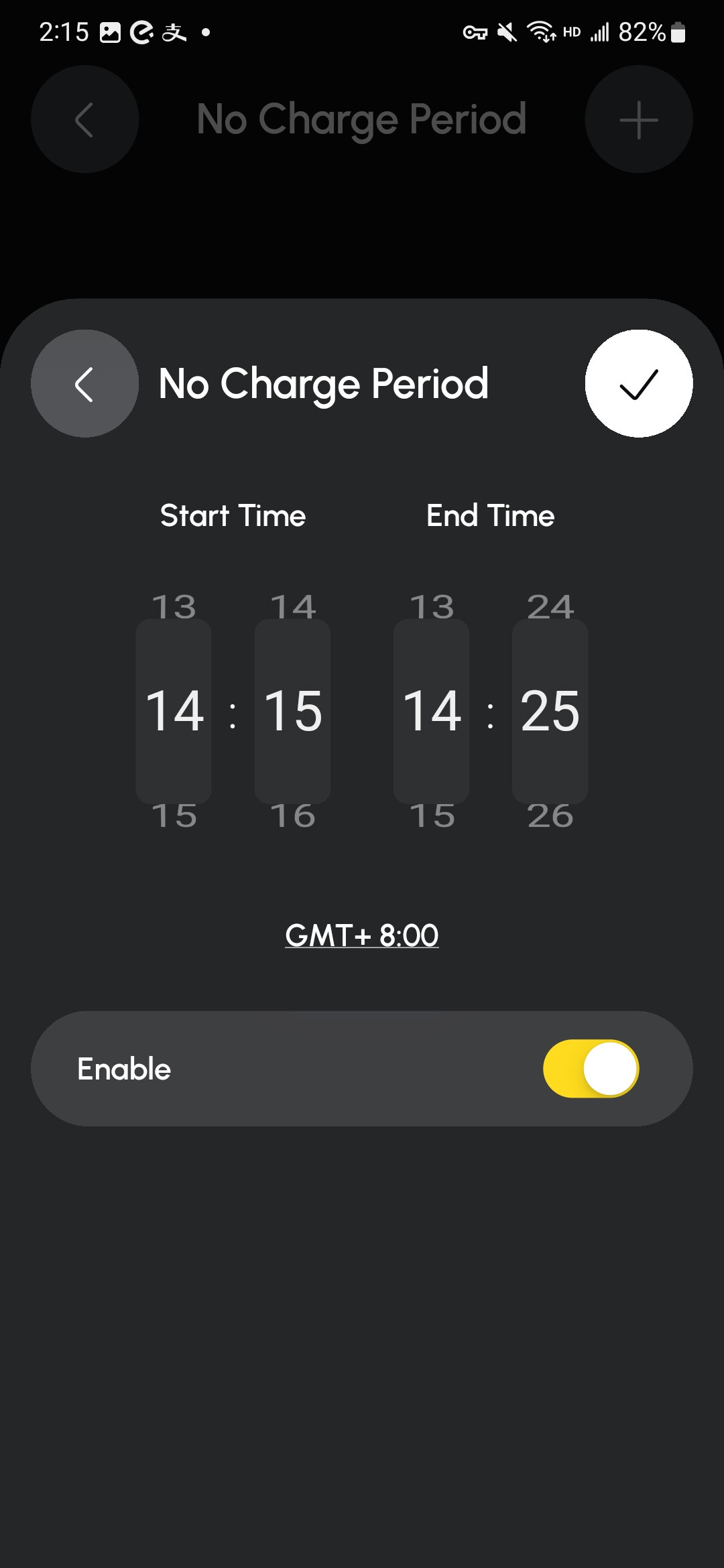

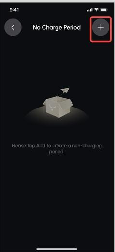

  1. Non-charging Period:
You can set daily non-charging periods in the app (e.g., 17:00–20:00). The minimum interval is 10 minutes, and the feature is disabled by default.
How to Set A Non-Charging Period?
  • Open the Settings page in the app.
  • Navigate to Work Preferences → Non-Charging Period.
  • Tap the “+” icon in the top-right corner to set up your desired time periods.
  • Tap the “√” in the upper-right corner to save your settings.
Note:
  • If the Yarbo’s battery drops to 10% or below, it will automatically trigger emergency charging, restoring the battery to 30% before stopping.
  • After the non-charging period ends, the device will automatically resume charging.
  • If you manually trigger charging during a non-charging period, a pop-up notification will ask for confirmation to proceed.

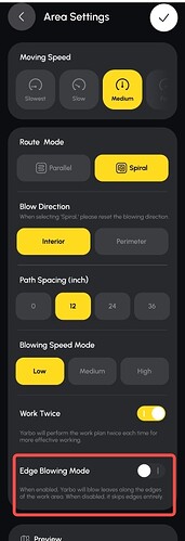

14. Edge Blowing Toggle (Blower) You can now control the edge-blowing function using a toggle. It is enabled by default for all zones. When turned off, the blower will skip edge-blowing actions.
Note: The toggle cannot be adjusted while a work plan is in progress, paused, or when Yarbo is returning for recharging.
