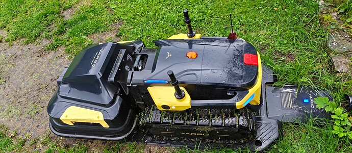

Yesterday evening Yarbo stopped working in the middle of the scheduled mowing plan. Side lights changing colors and orange light on top blinking. Didn’t notice how long it had done so but when I went to inspect what’s the problem the application showed that Yarbo is disconnected and suggested that maybe I had a network issue. Quickly checked that DC light was green and it had internet connection. I didn’t had time to deal with this issue more closely so when I returned home later in the night Yarbo only had the 2 back lights what changes colors on. Application still shows that it’s disconnected. So I did all the usual. First pressed the power button about a minute and Yarbo turned itself off but didn’t restart. So seconds push to the power button to get the core powered on again. Now all the lights started flashing and the mower unit tilted all the way to front, then back and then in the center position again. Like it always have done when I have needed to made the restart. After this usually in a minute or 2 the Yarbo have announced that it is “ready to work”. Not this time. The flashing lights where I’m about 10 minutes and then only again the back side lights where on. I did the usual DC power down, charging pad power down and disconnected the battery. Also disconnected the mower unit as I had to carry the brick back to the charging pad. It’s way easier or maybe also the only way to do it if you carry battery, mower and the core one by one back to the charging pad.

As a side note, what version of the core do you have? Is that the 2023? I ask because the charging dock seems very different to mine (Mine is a rectangle, nothing protrudes in the back). And your Halow antenna is on an orange support. I notice a few other differences…
And maybe you may wish to remove the winter extensions for your RTK antennas? Some day you’ll hit something… Just and unsolicited suggestion…
That’s a 24 on a 23 dock. The upgrade program let you upgrade the core and modules but you kept the dock and battery since they were compatible. The Halow thing is a 3d printed protector users have fabricated for it. They made similar ones for the GPS antennas too.

Bryan is correct in everything and to add to his information the extensions to the GPS antennas are the flexible ones Yarbo sent me to test. They worked great until the core unit died on me again.
I do highly recommend to use those 3D printed protections. They have saved me many antenna replacements. Both GPS and Halow. Now because I have the flexible extensions for the GPS antennas I have removed the protections for those
