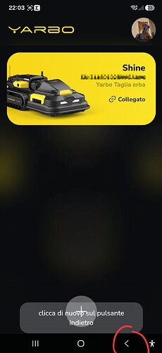

First issue found: the app doesn’t close if I click the back button twice, as I always have… Android system on S23+
Also a “known” issue with Android. I assume all, but maybe only some.
/sigh
