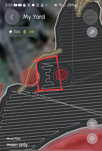

I have the same problem. I have trellises for my grape vines and fruit trees. They are about 6’ apart. When yarbo mowes in between them it does a zig zag pattern that is really rough on the grass in the middle. I use the diamond setting but it also does this on the spiral setting but not as bad. I ended up just making that area a nogo zone and I cut it with a weed eater.
Have you tried making that its own area and then adjusting the angle to get the lines parallel with the space in the middle?
This is my favorite approach.
I failed to understand what you meant by now but recently I think I understand. You mean setting the angle and then hit preview until it aligns?

Yep, I have an area that it was zig zagging like crazy. Lots of little turns. I set the route angle in increments until I got it to run long ways instead of the short paths. I turned off route rotation degree and have that area static to the same pattern for every mow. Works great. It’s mostly ditch anyways.
Today’s angle did enough damage here to follow that suggestion.
